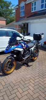

Not a very good picture but i have a WRS on mine which i like20240717_193446.jpg

Hi B.B ,WRS are they an Italian outfit and do you mind me asking what it cost and arrival times etc?
