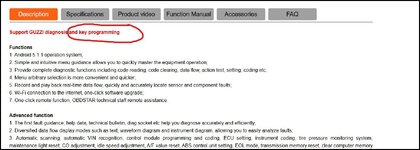

Ordered a Guzzi specific ODBStar diagnostics tool and it landed from China in 3 days, well packed and well spec'd and so far really happy with it. It works with the Stelvio and the V7 and allows you to diagnose faults, read codes and configure accessories.
As much as I love A&D (Watching for the spies :) :) ) it's a 100 mile round trip so if I needed to reset a DTC or the service light, it's half a day :)
Last night I fitted the Guzzi alarm system to the Stelvio, it needed coding in, the ODBSTAR detected it, I enabled the alarm, cycled the ignition and it's working perfectly.
Anyway, the point to the post is if anyone in the Northwest needs diagnostics or a service light reset, accessories coding in I'm happy to do that, I do know what I'm doing :) I'm a long term ODBEleven and VCDS user and work with them computermabobs for a living.
It's a decent bit of kit and pretty intuitive to use so far, there have already been 2 OTA updates.

Will it do euro 5+?
I assume it won't turn off the service due spanner?
It does and it will, the first update it picked up OTA added E5+ support and Service Indicator Reset.
Both mine are Euro V+ Al.
Great offer mate.
I’ve done same with car bmw diagnostics and bimmer code….. now I’ve sold the car 😂😂
can it code new keys ?
As of the last update it has the option to duplicate keys.
