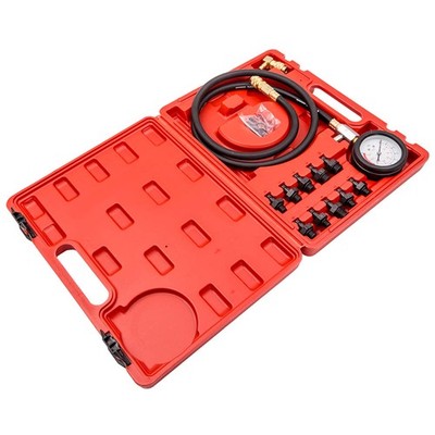

Thank you Mikey boy, I was hoping you would see my post, would you be able to point me to a suitable pressure gauge, and what would be a good reading. Thank you

Thank you Mike, ordered one from Amazon, here tomorrow, then the big reveal😬
Well, what do you make of this?
Connected up my new oil pressure gauge this morning, plugs out and earthed, cold crank, straight up to 80psi within ten seconds or so, reconnected the pressure switch, went for a quick tootle, about four miles or so, light came on, returned home, connected gauge, fired her up and at an idle of between 800/1000 rpm showing 60psi, rev to 4000 and showing just under 100 psi, so my suspicion is electrical, what are your thoughts!,

Rig up a t piece so you can connect the pressure sensor and the pressure gauge at the same time then all will become clear

If your gauge is showing 100PSI ?? :eek :eek :eek :eek The PRV should have blown to relieve pressure at about 60 ish PSI
I always worry about the cheaper chinese gear as you have no idea if it has been calibrated??

You probably don’t have the hard wear to hook up both the gauge and the switch,
At this point don’t worry too much about the accuracy of the readings,
Fasten the gauge where you can see it and go for a ride,see if the pressure drops off?
If the readings seem consistent mebbs concentrate on the wiring/ electrics.
