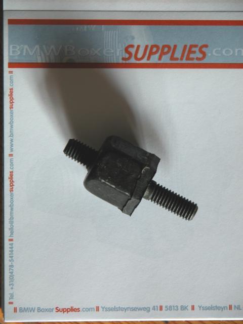

Tempting fate I know but my bike, which embaraasingly has been on SORN for 2 years now, has nearly 70,000 miles on the original shaft.
It has however had one set of new crankcases, four indicator flasher relays, three clutch pushrod bearings and 173 of those rear rubber exhaust mounting bobbins.
Wrong assembly... :augie
Tell me about it:mad:..they need to be a bit more :weights and 10mm longer.....and not make of chocolate !!:rob
Like this then;)
You can get a spanner on the male and female halves to tighten the appropriate nut so you don't destroy it as you install it. :thumb
