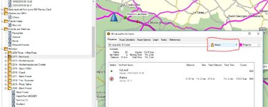

However, I have managed to replicate your problem. I did this by going into the activity mode e.g. driving, motorcycling etc and selecting option "Direct". This immediately produced straight lines which were not affected by the recalculate button.
Confusingly the icon for direct activity mode - highlighted in red - is exactly the same as the routing function - highlighted in blue.
