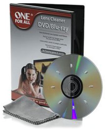

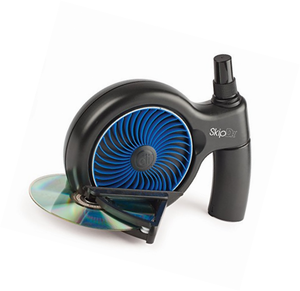

Id suggest the GPS will invariably ask for a registration code if a new disk is installed in the drive as it will read the serial number of the disk, so might I suggest getting a DVD disk cleaner like Skip Doctor to remove any scratched from the one you already have and a DVD lens cleaner may help too?

Andi, this the third disc I've had, neither of the two replacement ones needed a registration code, are you sure a new one will need one? The one I have seems clean and without any scratches and I've already used a cleaning disc, the one with the little brushes mounted on it that you show. By the way, if the disc looks clean, is that necessarily good enough or should I use the gadget you show in your post or something like it?
