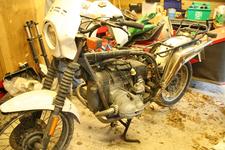

So this is the start of my thread on the rebuild of an R100GS.
Loads of enthusiasm - but just starting so lets see how long it lasts!!

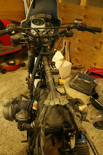

First the bad news ... she's a real state as she's been left to stand in the mud & rain for years ...
The bloke "Paul" bought the bike in pretty much this condition 6 years ago. Allegedly from some one that had ridden her to India. Then the good news: she runs! When he initially bought her she didn't but he pulled the barrels, checked the big end and little end float, replaced one barrel and a piston and replaced the valve, guides and springs.
On top of this we have
new sump guard
spare set of panels in red and pretty good condition
very good pair of forks
New seat
and ofcourse that 43ltr HPN tank
So now I'm over the initial shock and its down to business and working out how much its going to cost and how far I go with it.
I'll pick the bike up one night this week.

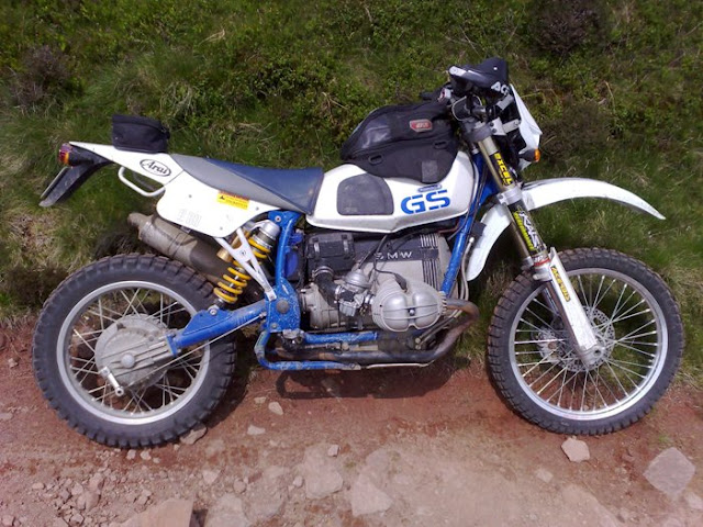

That is my old bike and it was originally like this
I didn't build it........................someone in Belgium did
Cost including original bike was 13000-14000 Euros, all in
Sweet thing..........................but not very rideable on the road...............it was/is very dirt orientated
I find my G650XChallenge....................beats it in so many ways - chassis/power/suspension/brakes/handling/price.....................but not charisma though

Interesting - why wasn't it ridable? The one thing that has inspired me to build one like this is that my g/s is very ridable - I just want more of it.

The Yamaha WR450 KYB forks were too long and raked, for stability in the dirt......................which made not for a good handling roadbike
Ok that's useful to know - I don't suppose you'd have any measurements on that so I can ensure I don't go that far extreme
There are a number of threads on the subject of the best set up/geometry for modified airheads in the 'olds cool' section on advrider.
The WR forks could be dropped through the yokes a bit to try to make it a bit more road friendly but it's always going to be a bit unpleasant on the road on those tyres.
