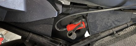

Just bought some puig frame infills for my 2022 gs
But I have noticed that my charging point will be covered over by the infill
Have people moved this charging point to somewhere else if so to where ?
I simply took a dremel to mine...
I'd earlier covered it with a "carbon effect" vinyl. and before that, I had mounted a socket in a panel below the top infill - hence the hole that you can see - but that was a pain.

I got a cheap Chinese one and took a Stanley knife to it, a couple of self tappers, job done.
Two bikes and 50,000mls later, still going strong
I have the Wunderlich ones and just drilled a hole in it. Then got it carbon dipped. You can lift the flap and plug in. No problems.
