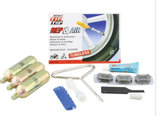

http://www.ebay.com/itm/Rema-Tip-To...e=STRK:MEBIDX:IT&_trksid=p2057872.m2749.l2649

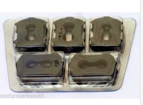

POS, IMHO. I got through 3 of they trying to fix a puncture for richardbd of this parish outside the Falkland Arms in Great Tew. We gave up and used something else which did work, just after Richard lost all hope and had called the RAC. Sticky strings haven't failed to work since.
I'm with Chazzy on this.
10 miles outside oban, tried 3 of the rema things and they didn't work.
Recovered back to Leeds.
2 weeks later a puncture big enough to put my finger in on the hard knot and my mates sticky string got me home.
I have used the plastic screw in plugs as well and to be fair it got me home but it wasn't a permanent repair like all the stop and go fixes have been. Did get me going again though and they couldn't be easier to use.
