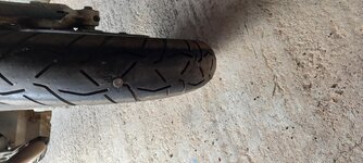

What are peoples attitude to a front tyre puncture? Repair or replace.
The roofing nail is just off the centre line and not leaking at the moment. If it was on the rear I would have no hesitation in a repair. On the front, not so sure.
Pull the nail and plug it
It will be fine
What's the worst that can happen
A good repair will be fine, once the nail is removed the rubber will close up, get a tyre fitter to plug it glue it and it wear the same as the other parts of the tyre.

Picture below.

Is it a nail? Is it something else? Has it actually gone trough the tyre? Looks like something pluggable to me. If you don’t feel comfortable with a plug a repair from the inside would make it as good as new. JJH
It looks like a roofing nail to me.
Where I parked the bike yesterday there were builders removing lead flashing, to I guess the culprit is a galvanised roofing nail. If this nail was holding up lead flashing then it will have gone through. Never saw it.
Still I think that it will be repairable (or I would not offer it) but if my good lady is concerned about it then it will be changed. If it had happen on a long trip I would have pulled it out and plugged it. I carrying those externally fitted plug + inserter.
I would have it and would pay for postage if that's OK with you?
Thanks Karl.
That's a perfect example of a Perfect plug. Just plug it. You'll forget all about it, until its time to change.
AS above, just get it professionally plugged from the inside, the tyre repairer wouldn't do the job if it was't safe.
