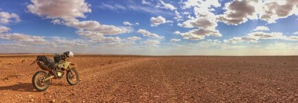

It’s the way to go...
15.5L tank good for 200+ Miles
GrandLoop stays nice and tight, carry’s the weight low and forward and when standing you can wedge your legs back on it
Small 10W LED spot on a ram mount is very versatile and easy to adjust on the move

hi,i have owned my 690 for 8 yr and in that time i have had 1 blocked injector
mine was the first or one of the first rally raid bikes
first trip away on it
it evolved into this
and now i have junked all the injection stuff and put a carb on it same as the rally rep 690...was 2 ecu's 85 wires load of sensors shit fuel pump....now 1 ecu 13 wires even without a pulse fuel pump i get 10ltr from the rear tanks and 4.6 from the front 2 gravity fed...getting around 55-60 to the gallon pulls like a train or like a 525 on steroids
