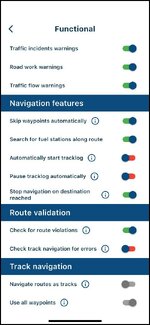

Now it’s getting frustrating! Riding a route. Needed petroleum click on fuel icon. Tells me this way point cannot be added to a track. It’s a route I created myself this am. I have re opened the route AND set all options to go online ( not that that should make any difference). I have re looked through functionality settings. Screenshot below. Routes are already set to NOT navigate as tracks. I logged out and back in again. Re opened the route and started to navigate. Again tried fuel option. Same result. What is going on
I think it is something to do with it being a track Don.
Have you converted track to a route? My understanding that when following a track*, it will not allow to add a waypoint. However when you have a GPX route, then adding and shifting waypoints does become possible.
* it is a bit like following a highlighted by you and desired to be ridden road on a paper map, say in fluorescent yellow highlighter.
A track is like a line on a map, you can follow it, but not much else. The track needs to be a route to be able to add waypoints to the route. Could be wrong of course.
Don, I am pretty sure the posts above will have answered your question. When exporting from MyRoute, it’s quite possible that a route AND a track are sent across. It looks very much like you are navigating along a track. If so, it very much limits what you can do. Pretty much, yiu are limited to following the line of tge track and that’s it.
