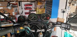

I have a 1977 R100/7 which I’ve owned from 1980 and it has always had an S fairing on it.
My question is:
Would the handlebars of the R100S been lower than the original R100/7?
Has it got S bars on it?
Reason is 40 years later I’ve got used to sitting in a more upright position with wider bars (Like my V7 behind it) and I’m thinking of making it original again.

Many thanks to you both for such a comprehensive answer. The first bars look exactly the same as mine.
Underneath the crash pad of the low miler R100, it's exactly the same bars again....apart from being drilled for heated grips, same bars also fitted to the R100CS...

After a few false starts with rubbish pattern bars I moved the bars with Rok type risers.
No need to pay Rok's silly prices, they are available on Banggood or AliExpress for a fraction of the price.
After a couple of weeks and a few hundred miles I’ve rebonded with the bike it’s bars and it’s S fairing and am going to leave it as it is.
Sometimes you need a bit of time.
I’d forgotten how comfortable it really is. Just a different riding style from my more modern bikes.
Thanks again for all your advice regardless.
