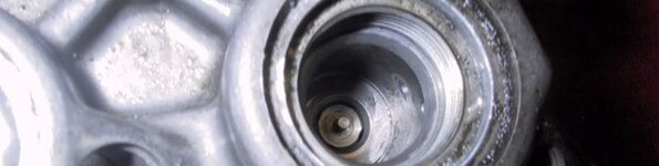

Coming into this somewhat late but can the OP please advise how he removed the plungers.
I can remove the top of each cylinder on the ABS unit, together with the spring, ball bearing and
seal ring but nothing else will move. Obviously I don't want to damage anything by prying too
hard so I would be grateful for any help.
Thanks

I did this for the rear piston on mine, and it pulled up ok, using long-nosed pliers in the central peg, after removing the filter/seal etc.
The piston has an o-ring seal on it, so possibly that has stuck?
OK> Thanks for that. Not sure what you mean by 'peg', but I can feel a ridge inside the top of the piston.
I'll give it a bit more heave ho t/morrow.
The really stupid thing about this is I had the pistons out a few years ago and don't remember any difficulty
then!!
Peg
This is an extracted photo from the procedure on ADVRider.com, which shows the peg on the top of the piston.
I suspect you're still looking at the filter that sits above the piston and needs a little bit of persuasion to pop out. Then its the view in the picture above ^^^^ and needle nosed pliers work a treat.
