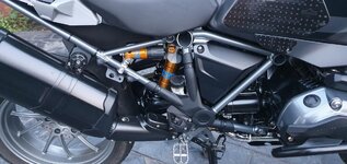

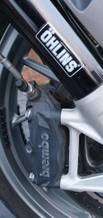

What I like about Ohlins, is the stickers....
Ohlins... yeah baby :D
