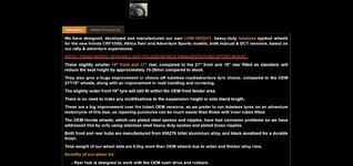

However, for purely road use, RallyRaid offer two Africa Twin wheelsets which are tubeless tyre specific.
Option 1) 21" front and 18" rear.... but 21" front is still a very odd tyre size for tubeless wheelsets..... and not so good for on-road handling. This option is ideal for off-roading but with a need for tubeless tyre convenience.
Option 2) 19" front and 17" rear.... as this gives a much better on-road bias for tyres and handling.
http://www.rally-raidproducts.co.uk/Crf1000l-tubeless-low-wheels
RallyRaid provide both options.... and on their website they say works for Manual and DCT bikes.

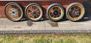

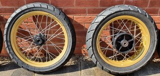

Got some pictures of the new RallyRaid Wheels
Group Shot is
21" Front Wheel
19" Front Wheel
17" Rear Wheel
18" Rear Wheel
Ordered a new set of brake disc bolts yesterday (front and rear)..... so just waiting for them to turn up.... scheduled for Monday.
Then I'll get the brake discs swapped over from my other gold wheels and get these RallyRaid ones set up with the discs, ABS Reluctor Rings and new sprocket.
Got hold of a spare Sprocket Carrier, so will set that one up with the 41 tooth jobbie, so it's an easy swap over.
So now should have a complete setup to simply swap over once either a road trip, or Winter arrives.
Very interested to see how it changes the bike.

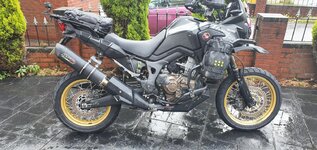

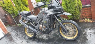

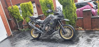

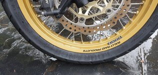

Well today I got around to fitting these 'new-to-me' Rally Raid Tubeless wheelset. Really nice :thumb2
Makes the bike lower, more 'racy' looking.

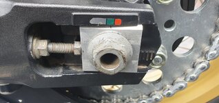

I set up the chain slack, with the bike on it's side stand, and the markers never went into the red (makes me wonder if others were setting chain slack on the centre stand).
Anyways they look great, really nice.

What do you think? :beerjug:
Just got to take it out tomorrow now and test ride it on DCT.
