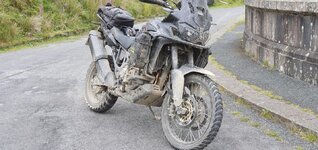

I was thinking about upgrading my wheelset a while back which would be more suited to off-road use.... as I don't think the standard wheels will last long before getting damaged.
The RallyRaid UK company offer a couple of wheelset options for the Africa Twin, so I chose the 'Rally' tubed version... which gives me more flexibility on Rally sized tyres (enduro tyres and rimlocks etc).
The main reason is strength and reliability as RallyRaid provide stronger rims, stronger spokes and bigger bearings better suited to off-road punishment.
I spotted a Clearance Deal and they were £996, which isn't too bad.
Hopefully it'll be a finishing touch for this years off-roading fun :)
