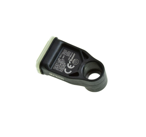

Got my new sensor today.
Changing from the original (left photo) to the newer type (right photo) also requires a new shorter bolt. Just had tyre dismounted (after 15 minutes of wrestling with a vice & clamps) by my local bike workshop & have now got the bolt on order. Wish I’d known! Never mind, live & learn.

SORTED! 👍🏻
Re-fitted my wheel today & went for a ride to see if the new sensor worked.
Initially, only the rear reading appeared but within 3-4 miles of me setting off, the front reading then appeared. Phew!
Thanks to MartinK for your time/information & Thanks also to Andy at Transits in York for the tyre & sensor fitting.
Whole job inc parts, del, & labour came in under £70 which I guess is cheaper than the OEM sensor itself.
New bolt for the 3141M sensor approx £7

Finally just completed mine with an eBay/Chinese one:
-Originally ordered the wrong one with valve.
-Thought I'd get a bead breaker/tyre changer as it would pay for itself.
-Had to drill out the new Chinese one as the bolt wouldn't fit through (seems common)
-had to upgrade my Motoscan as apparently you need to delete the old sensor as it only holds one code
-bike is sorn at the moment so couldn't get it to register riding up and down the street
-ordered an activator from ebay
- hooray all sorted.
£100 all in but £53 for the tyre changer and £22 for the Motoscan ultimate upgrade, £11 for the wrong sensors, £1 for the activator.
Next time only the sensor to pay for (it was only the front playing up)
