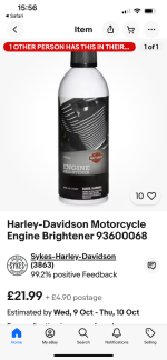

I know it’s a long shot, but you might want to hit the engine fins with a toothbrush and degreaser of your choice. Then apply Harley Engine Brightner. Depending on how things go with the engine, I’d maybe consider new calipers, but definitely cheaper to have beed blasted and powder coated.
I’m sure you’ll discover other gremlins too.
It’s never fun buying someone else’s neglect 😬

The black engine finish gets very dull, almost grey in colour and can be rejuvenated with the genuine Harley Engine Brightener, leaves the same finish as standard without making it shiny. I believe S100 do a similar thing but have not tried it.
I have always use the HD back to black engine restorer spray that @GSite mentions, which I was told is an S-Doc product. Just make sure all the salt/shit is cleaned off thoroughly first.
