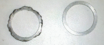

I'm all for it but there comes a time when they have to be replaced.
I serviced my RT for the first time since I bought it in July and here's what the washer looked like. FFS!
A new washer is shown for comparison just in case anyone is wondering what I'm whinging on about :augie

Ah, but did it leak?:augie They go ragged like that when the socket goes over the stub that the bolt is threaded into and chews it as you give it the last tweak. You could do it with a new washer or one that you have re-ued a few times...s

No, it didn't leak but I've never seen one like that before. I reckon it's as old as the bike - 8 years. It would just have been my luck that it started to leak if I used it again.
I never changed that washer on my old ER-5 in 50,000 miles. That's 12 oil changes and it still looked brand new.

Never believe a word from a BMW main agent:D Honest though, they obviously thin and spread with a couple of uses but the ragged edge IS due to the socket 'cos I have done it a couple of times. Looks like a dogs chewed it...
The trouble with crush washers is that when new they feel like the thread's going...:eek:
