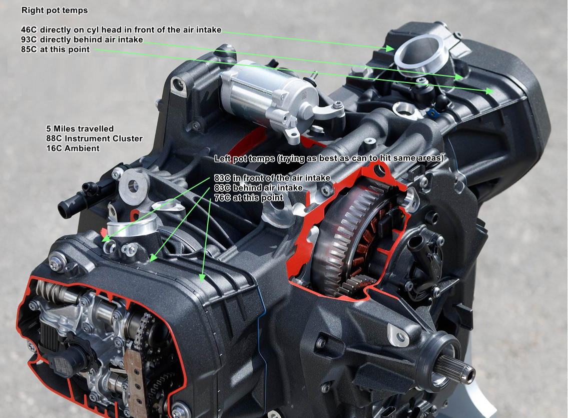

so been measuring the madness... then remembered the left pot is back to front vs the right pot - so if you measure the same point one side its the cam chain tunnel and not on the other side
but regardless the madness is there - and its consistently crazy - its not random temp values from dodgy readings - its REALLY random engine temps
today I measured front and back of the air intake and for continuity of the other day the same point nearest the rider
5 miles in incredible temp variation on the right pot either side of the air intake

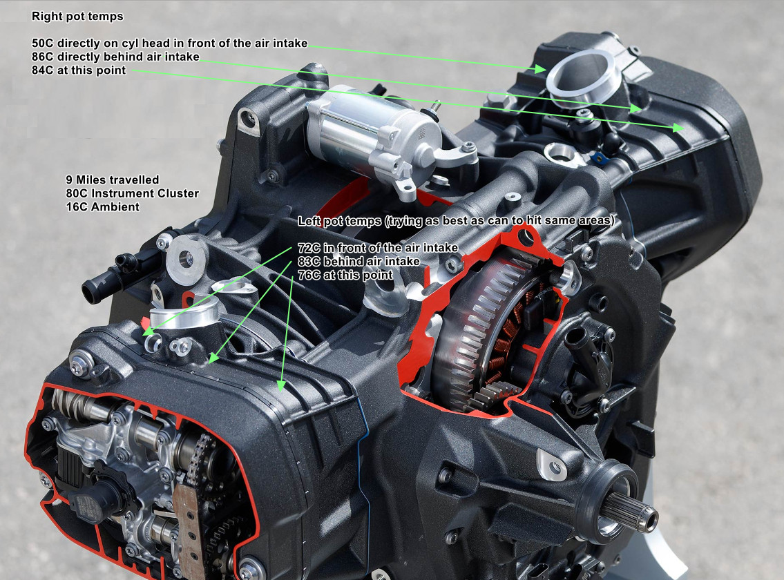

9 mile up right pot remains crazy and now the left pot went weird by 9 miles
