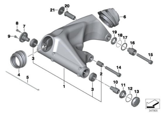

A friend has just bought his first GS (1200GSA 2006)
The rubber boot between the back of the gearbox and the sing arm is split and perished. I'm assuming this is a PITA to replace ?
Anyone had it done to their bike by someone, and what kind of cost was it ?

Swing the final drive down, remove driveshaft, fit new gaiter inbetween gearbox and swingarm . Replace driveshaft and relocate final drive.
Not quite as easy as it sounds if doing it for the first time.
Very fiddly in real life .. especially holding the gaiter off the gearbox while locating the driveshaft onto the gearbox output splines and then hitting the end of the shaft so it locks onto the gearbox splines, and then getting the gaiter over the gearbox lip.. I’m pretty good at it now after plenty of practice 😄

they were never meant to be water tight - on the LC bike's they are drilling a breather hole at the back to let the thing breathe better as some have got water in and it didn't come out and caused corrosion - it helped with the drive shaft wear that's become problematic where vehicles with the bevel drain bung, didn't have the shaft popped of the splines regularly
I think it's a relatively easy job, no major difficulties as I see it. If the motorcycle is as old as 2006 and recently purchased, I would not only replace the front rubber boot. I would dismantle the final drive, swingarm and driveshaft and clean all splines and all bearings. I would then carefully inspect the driveshaft! Then I would grease everything with the correct grease and reassemble with the correct torque. Of course, you should also change the oil in the FD. The first time I took off a swingarm on an R1200GS, I had a hard time understanding why the lower shock absorber mount was so tight and so difficult to get loose and even more difficult to reassemble. The swingarm has a sliding bushing where the mounting bolt goes through that is press-fit. I chose to move the bushing a little before reassembling using a simple puller that I built with a bolt and a nut. Otherwise, everything is simple.

It's fine if the bike has a centre stand, less so without.
I did it on my RT, relatively easy (with the right tools) - less than 90 mins.

Update on this - The motorworks part is their own pattern part and its lasted only a couple of months and a few thousand miles.
I noticed that the boot had seperated from the plastic ring the other day.
Had it all apart today and comparing it to the old one, which I still had, its clear to me that both the rubber and the plastic rings with the retaining teeth are much poorer quality & fit than OEM.
Ordered a replacement direct from BMW - £61 delivered
The Motoworks part was £47.50 ex delivery
