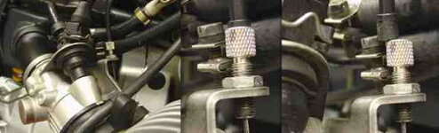

Rode my adv back from a main dealer after a 12k service yesterday and thought it was a bit more noisy than normal but after not riding it for a while as they had it whilst I was away I thought it might just be me hearing things.
I have left it overnight and started it this aft and it is definetly rattling more than before and the revs are moving between 900 and 1200 ish whist idling.
Any ideas? Not going to mention the dealer (yet) as I am happy with the service overall and am quite happy for them to look at.
Check they have put the little blanking plugs back on the throttle bodies after they checked the TB balance (they are little black nipples at the bottom of the tb's), and that they haven't displaced the TB cables.......someone will be along with a picture shortly :D
running rough
Thanks for the info chaps, will check it tomorrow, would seem to a common problem then? :thumb
