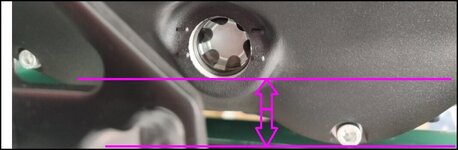

Fair comment but look at the photos.... Absolutely no oil at all
Just rode my Bear home from it's first service at GS Motorcycles at Ballymena, 50 + miles of motorway speed.
Got home and noticed really tingly fingers, never had that before.
Trying to figure out what caused it / what is different...I checked the engine oil....
Not a drop !!
Where do I go from here ??
Robbi Stop Flapping !!
It is quite possible there is oil in there
You just cannot see it because it is so clear and quite possibly "just" below the sightglass
So IF you want to know for sure? Go get a large enough measuring jug / container and crack the sump plug and drain it down and measure it

Fuck me you're hard work...I followed the RE instructions !!
Got a mirror? I’m only trying to help. The bike holds about 3 liters of oil. Only the top .5 shows in the sight glass. It might need topping up. It’s still not ideal to collect your bike in this condition but not terminal. As for your request to fuck you. No thanks. JJH

I think there is "some oil in there"
JJH is right there is no way that you would have made it 50 miles with no Oil Mucker !!!
It is quite possible that there is oil in there just you cannot see it
I'm with Robbi on this, it doesn't look like there's been any oil in that sight glass at all. Robbi, could you see anything before it went in?

I'm suspecting there's something wrong with he sight glass. Bear does have an oil light. But that doesn't explain the tingly finger feeling on the ride home. Whatever, it's and issue for the dealer to sort out.
