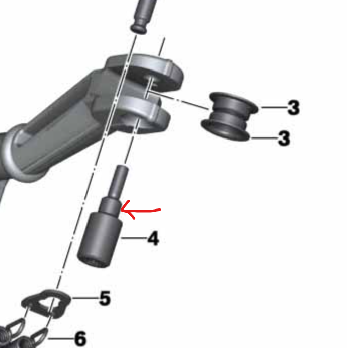

I know this is an old post, but I'm sure people will still have this issue. So, my 'solution' for this...
According to OEMParts, there are 2 brass collars (#3 on diagram) that can be replaced, but I also read from others this hardly fixes the issue. It seems that the design of the stand makes the 'fork' part getting wider over time.
The fix is relatively easy I found out. Just disassemble (Torx 5.0) and put a small metal washer on the inside of the assembly (by the red arrow on diagram). Than just reassemble and tighten the bold firmly.
Due to the washer, the fork parts (excuse me for not knowing the exact English word for it) can now be pulled closer together, decreasing the play and making the stand work as it was supposed.
No more risk of tipping the bike.
Total time: 10 minutes, total costs: 0,001 pence
