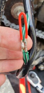

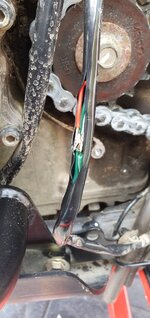

I decided to delete the side stand switch on the Africa Twin DCT.
The main issue is a really annoying "settings reset" default on these DCT bikes every time you turn the engine off.
So when off-roading, you'll go through the following:-
a) Turn Off Traction Control
b) Turn Off ABS
c) Turn On Gravel Mode
d) Turn On Manual Drive mode
Then, whenever you stop the engine using ignition or kill-switch, everything resets back to default
D) Default Traction Control setting Maximum
D) Default ABS On
D) Default Gravel Mode Off
D) Default Manual Mode Off
So you have to go through the whole procedure again. PITA :blast
Now there is a caveat here, that if you put your side stand down it'll kill the engine but your settings stay in place.... But then you're constantly restarting the bike over and over.... especially going through field gates repeatedly.
Which means the best solution is to delete the side stand switch so the engine stays running. So you can come to a stop, get off your bike, get back on your bike and continue. No settings lost, no restarting engine, job done.
I found that the side stand switch only has two wires, so I soldered a link wire between them both and ensured 100% continuity.
So now you can ride off with your side stand down and kill yourself :thumb
The other benefit is that if/when the side stand switch gets SMASHED OFF against a rock... my bike will still work and get me home :bow
Much easier to piss-about sorting this PITA out on my driveway, rather than have to try and figure it all out trailside with a broken bike.

I did actually think of doing that, but this bike is only used off-road.... and I don't want to get into yet another switch setting to mess with.
The MOT Guy said a non-working side stand switch didn't bother him.
So no reason just to wire it up completely.
