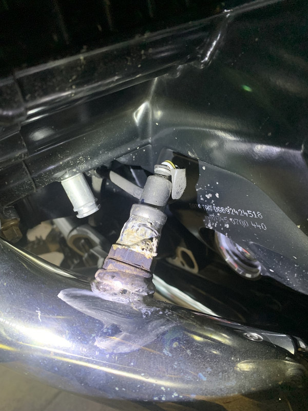

It wasn`t the headlight..................
I think i`ve found it, and it wasn`t the headlight!!
Went out again today and the nasty niff was back.
This time, when i got home and the bike was back into the garage i left the motor running and got on me hands and knees with a torch and had a poke around.
I soon discovered the smell`n`smoke was coming from the r/h lambda sensor!
This particular component caught my eye only the other day as it looked very `weathered` and not at all like the one on the left which only showed signs of normal heat discolouration.
I don`t know whether the r/h smokey one had a label left on it, or maybe some kind of protectice plastic sleeve which should have been removed on the production line or what, but whatever it was it has melted, was sticky and gooey and was deffo the source of the wayward whiff, the smoke rising from under the headlight area i saw last week was a red herrring. When we stopped today during the ride we both had a good sniff around the bike (receiving some odd looks from passers-by) and my best guess at that time was that it might of been coming from underneath the tank. The headlight/heatsink were both cold to the touch.
