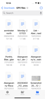

1) Open the File app on the iPad, create a folder called GPX or some such and drop your GPX file into it - you can save it from an email, or from whatever app you created it in, or from a download like the TET website.
2) Connect the Montana to the iPad - I use an Apple USB C to USB B connector and the Garmin micro USB cable
3) The Montana appears in the File app as a mass storage device
4) Find your GPX file, long press and "copy"
5) Navigate to the Garmin>GPX folder on the Montana. Long press, "paste" and you'll see your GPX file
6) Disconnect the Montana, then Where To>Tracks, and your track will be there!

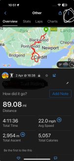

Connect DOES do file transfers on IOS
Long hold on the file.
Scroll down to "Share".
Tap on it.
Then if its not showing on the top line, tap on "... more".
Scroll to Connect.
That will open Connect and you then choose the type of activity - I use "Hiking" otherwise sometimes it will change the .gpx like Outdooractive does.
Tap save.
Simple.

You can then either let it sync or send it to the device.

Isn’t that still done via the Connect web site though, not Bluetooth?
It looks an update to the last time I checked, but in any case it’s pretty easy to transfer using a cable and file manager
Looks like it is Bluetooth, so,good find - I’m sure this is an update, as last time I tried it wasn’t possible,to share with Connect.
