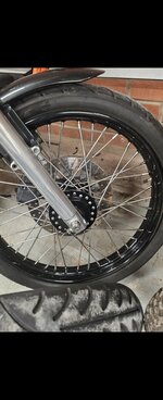

Just out of curiosity how do you mean the wrong order? i don't know anything about spoke building but i was assuming they are all the same length and get seated in and then each one pulled in/out slightly to find true, my first thought was has he cut one slightly to long and not had enough adjustment but again i dont know feck all about wheel building haha. cheers
The ‘heel’ of each spoke is interfering/touching an adjacent heel. It shouldn’t do this.
Your last two photos show it fairly well. Consequently, that’s why the heel is not seating correctly in the axle flange hole.

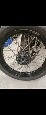

Yes i see what you mean i just picked the wheel up and they are indeed touching, i think the also the angle of the bend must be wrong as although its about 4 that are majorly protruding and out all of them dont sit down into the seat flush where as even when i took the original wheel in they were all sitting flat and my 21" refurbed wheel they all sat flat.
For reference to that hear is the wheel before i took it in and also my 21" currently on my bike which wheelworks did a couple of years ago they did a fantastic job.
