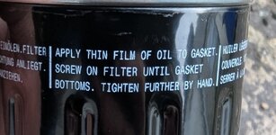

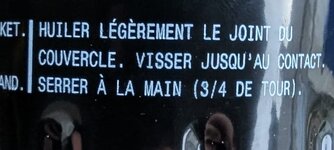

Oil filter is until hand tight and 3/4 of a turn that is Three quarters of a turn.... Not 3 or 4 Farmer Booiiiiii! :D :beerjug: They say 11Nm but that hand tight and 3/4 of a turn was the instruction when I was at the BM workshop supervisor by a 30 odd year BM master tech when mentioned that surely there is an easier way instead of getting a torque wrench every time!
The OC306 used to have that printed on it in french :hide:hide:hide
