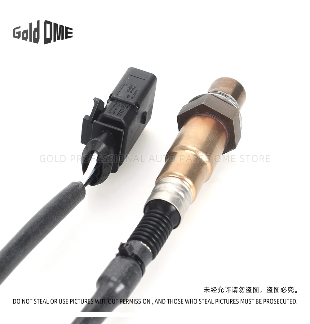

Both exhaust O2 sensors have about 40mm of uninsulated cores exposed and I'm sure this isn't right and should have an overall insulation - comments please.

o2 sensors - some with not covered by the black insulate can be seen about 10mm on both sides on my bike.

I put tape around the exposed cores - dealer should have seen and fixed this.
The lambda sensor wiring is pretty standard like that in most vehicles. The sheathing is only there for abrasion resistance.
The thinking being that nothing should be able to rub on it that close to the sensor.
The wires are sealed into the sensor so the sheathing isn’t there for water tightness or anything.
I was thinking more about potential damage from stones, etc. breaking a wire.

This is how every oxygen sensor is done on every car, truck and motorcycle. This is 100% not a problem. Dealer should never try and fix something like this.

Apparently the gap between the outer sheath and the inner wires in the lamda sensor is supposed to be there. It's to allow air to flow & affects how they work.
You should remove the tape you added
From a Bosch internet article :--
" the tiny amount of space between the insulation and wire provides enough room for air to seep into the sensor (for this reason, grease should never be used on O2 sensor connectors because it can block the flow of air). Venting the sensor through the wires rather than with a hole in the body reduces the risk of dirt"

The gap on the insulation is supposed to be there, it allows air to flow between the insulation & the inner wires and is by design. Sounds strange but it can affect how they work if you tape the ends up.
From Bosch :-- " the tiny amount of space between the insulation and wire provides enough room for air to seep into the sensor (for this reason, grease should never be used on O2 sensor connectors because it can block the flow of air). Venting the sensor through the wires rather than with a hole in the body reduces the risk of dirt ".
I still have 10-20mm gap but reduced it from the 40-50 it was.

no - that's the small 1mm or so holes you'll find around the metal bit - it compares outside air to exhaust gases - no one ever explained how the bike works when driving in a monsoon
oh no this one is made correctly too
Think I'll believe what BMW do, & what Bosch say, rather than what you say.
Quote from Bosch --
"Venting the sensor through the wires rather than with a hole in the body reduces the risk of dirt ".
