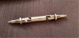

Yay, my BMW Tool 83302327790 - Alignment Pin arrived today from Lithuania. Nobody else had them as they are listed as 'no longer available' :blast
So now I can at least be sure of accurate TDC when checking valve clearances :) ... and moving forward on cam chain timing..
Frickin like Gold Dust these tools :nenau

Just got back from the dealer, and price for the tool is NOK 535, or, at current rate, £49,61.
The old part-number, 11 0 822 is no longer in use. The new part- number in the BMW system is: 83 30 2 327 790.
My dealer suggested it would take hime a week or two to get it.
So... Just let me know if you want it.
Cheers.

Ooo.. thats a nice tool Sir.. how much was it... £50??.. looks very nice for that amount :)
Yeah, this is BMW don't forget. So try £65 and you'll be on target :D
But may as well have been priceless.... as you can't get them !!
even at £65 its not bad.. looks quality and you can retract the pins out of the way for turning over..
was going to make my own so won't be quite a nice as this (just 2 screw in plugs), but will cost me about the same by the time I've worked out labour etc..

Yeah exactly, was very lucky to get the TDC Alignment Pin, as that's the one needed for valve clearance checking in the main.
It can still be done without, but it becomes more of an 'art' rather than being a no-brainer
