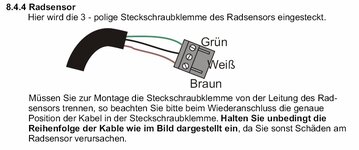

Terry Ryan is round mine at the minute. we're fitting an IMO 100 computer to his bike. We have a problem with the wheel sensor connections - there's no info in the docs that came with it to show the right connections for the three wires (Brown, White, green)
Any body know how they connect into the terminal box?

Is there no symbol on the sensor to show what the wires are ?
(Our proximity switches in work have a small circuit symbol on the body)
Bearing in mind the three are going to be two for feed and one 'switch wire' don`t two of them match the loom colours for the supply ??

Theres no markings on the circuit board and three unmarked wires from the sensor, the sensor is encapsulated. I've used my multimeter and found a connection from the sensor wiring that goes through to the supply -ve to the unit. One of the sensor wires is brown and thats usually ground on BMW wiring. Apart from that theres no indication at all of what the wiring should be. I've tried a magnet next to the sensor but get nothing from the sensor on my multimeter.
The one that goes through to the -ve is most likely the 'switch wire'.
Sounds like it`s NPN with a negative pulse.
I don`t think an inductive proxy will pulse without a supply on it so a resistance or continuity test with a multimeter may be unsuccessful.....

I think this is what you are looking for:
Thats the one michel thanks. I found some info earlier on the American Touratech site, unfortunatly, it looks like Terry's sensor is knackered. We got everything else wired in though, including the fiddly warning light panel. Do you know if the IMO is supposed to switch between Kph and Mph? seems a bit of an oversight if it doesn't. The manual that came with it isn't very informative.
