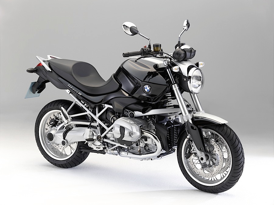

What sort of wheel are fitted anything Spoked on a BM from way back has been laced to the outer rim and are tubeless wheels
Centre laced Spoked are not I.ve never seen centre laced except on GS or G?S conversions
Decided to have a look see
What fucking idiot took the retrograde step to go back to centre laced rims on a Beemer probably som efucking Number crunching Hoofwanking Cockwomble to revive the old phrase
Anyway OP there are a few kits out there My friend just ran many many layers of good duct tape around the centre of the rim building up quite a layer of tape in alternating skinny strips to the outside and a wider strip over them
Its forced outwards and worked well on his Africa and his wifes Africa Twins for 25K before they changed bikes
