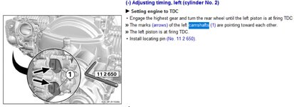

Valve clearances came out as follows:
And the valve gear all looks nice and clean as well:
All looks good and the clearances are all inside tolerances. However - it's getting close to the tolerances, in particular for the Right cylinder exhaust valves and the top intake valves on both cylinders. I need to plan to replace the shims here to bring it all back towards minimum tolerances.
So some questions for those who know what they are talking about!
1) Would you replace the shims on ALL the shims at this point, or just the ones that are close to maximum tolerances? Half of them are right at the midpoint between min and max tolerances.
2) If replace ALL is the way to go, would you then shoot to get everything as close to the minimum tolerance as possible? Or aim for midpoint? Or somewhere else?
As to the procedure for changing shims, I have read up on it in my Haynes manual, read some threads here and will watch some youtube videos later. But - is my understanding of the procedure correct?
1) Cold engine at compression TDC for the relevant cylinder
2) Measure and record current valve clearances and compare to factory spec.
3) Working one valve at a time, remove e-clip, remove cam follower, remove shim and measure shim with micrometer
4) Do some maths.
For example - Exhaust Valve A. Factory Spec is 0.30 to 0.40 mm. Measured clearance was 0.38mm (0.8 away from factory minimum).
Factory fitted shim says 5.0mm, but measures 4.6mm due to wear. To reduce clearance down to 0.30mm, I need an additional 0.08mm shim thickness. Therefore the correct replacement shim will be 4.6mm plus 0.08mm = 4.68mm. However that shim doesn't exist, so I need to round down to 4.65mm to avoid making the clearance too small.
Fitting a 4.65mm shim in this case should reduce clearance to 0.33mm
5) Fit correct shim, replace cam follower using new e-clip.
So is that basically the right way to do this? I think what will be tricky here is not to mess up the different valve followers and shims between the measurements and receiving new shims (unless Vines BMW keeps all in stock at all times and I can just nip over there and pick them up). However a piece of cardboard with proper markings and holes to keep everything organised should work.
Also, does anyone have any tips from experience of doing this to make the job simpler? It seems easy enough as long as I am organised and methodical....
Sorry for the long post, but I want to get this done properly!
