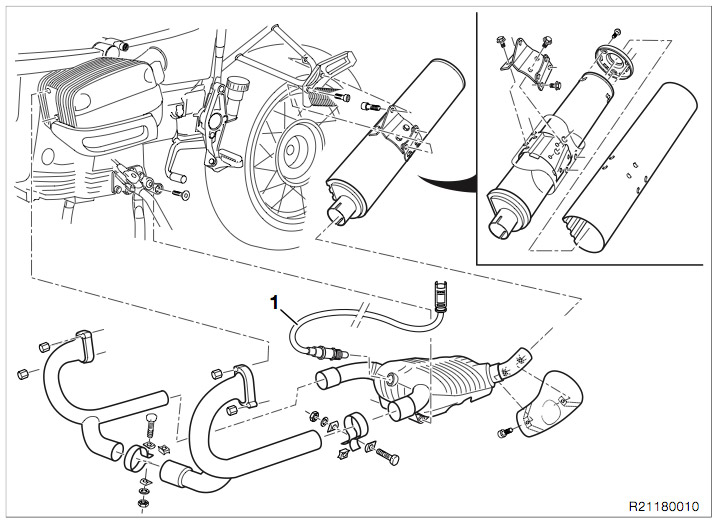

Quick one... are there/do I need to replace any seals/gaskets when swapping the old headers for my new coated ones?
If so, what exactly do I need?
2 X Gasket C18.21.1.342.463 £3.67 each = £7.34 + VAT
From your BMW dealer.
[Number 5 in piccy]

Hmm... downloaded a repair manual
No gaskets in my diagram :nenau
Is there any difference from early to late models?

you asked.I gave you info
the rest is up to you.
PS
If you look at your diagram,there are no exhaust studs shownig in the head.
Just the nuts,but they are in the bike. [otherwise the exhaust could not be tightened to the heads].
Just to reiterate Ash's post.
If it's anything like my 1100, you'll probably find that the gaskets are like concrete and impossible to get out with out risking damage to the head. I left mine where they were and used a little exhaust paste when I reassembled.

Ok thanks - good tip - I've got exhaust paste should I need it.
Thanks again chaps :thumb
