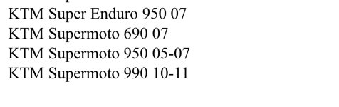

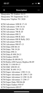

This list might be useful to some folk on here.
I looked at a set of decent quality bearings on eBay but the listing said they only fit 2008-2018 which seemed at odds with other listings that say their bearings are for 2008-2023 models.
The seller confirmed they will fit my 2019 690 enduro r bike and sent the list of others using the same bearings.
