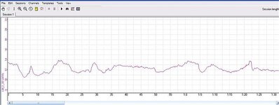

After much faffing about, chopping and changing airboxes about, fitting spacers under needles and trying different setups I'm almost there.
I've ended up with an old ally 100RS airbox and starter motor cover. Standard early filter. 158 main jet and the needle at the one and a half position from top - the half was a small washer under the circlip. The bikes running beautifully :cool:
Printout of the air fuel mixture recorded across the full rev range. a few cars on the road so it wasn't a wide open throttle run.
I'm not keen on the drone from the RS airbox so a little more tinkering to match everything to the standard airbox is on the cards.
Dead chuffed though. My new gadget is worth it's weight in gold.

what is this gadget of which you speak ?
One of these --> Gadget it comes with this software Logworks that you can either upload the data to or view live from a laptop. It cost £350 which isn't cheap but spread across 5 airheads and a couple of cars isn't too bad. So far it's been worth every penny.

I'd imagine it wouldn't take much in dyno time and saved faffing around backwards and forwards to justify it. Can the O2 sensor fit anywhere on the pipe or does it have to run 'hot'?
It's a Bosch wideband sensor with heaters built in so can fit anywhere. I bought the adapter to allow it to fit in the silencer, fitting in the collector box would be the best option though because air gets drawn back into the silencer when. you let the throttle off suddenly or change gear.
Apart from the BHP figure from the dyno run I get more information from this little unit and can see the results of any changes I make to the bike instantly. I didn't realise how smooth 1000cc airheads could run until I got the jetting right.
It's a Bosch wideband sensor with heaters built in so can fit anywhere. I bought the adapter to allow it to fit in the silencer, fitting in the collector box would be the best option.
