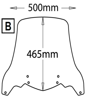

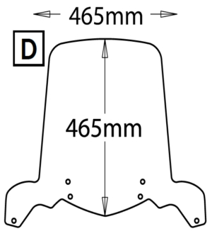

Isotta screen for F 650 GS from 2004 and on
Hi there
be careful when you choose your screen for your F 650 GS 2006,
because there are 2 types of screen with and without hand protectors mounted on the bike.
The isotta screen is larger and taller one you might find a good solution.
I was redirected from Isotta srl staff to one Austrian dealer Euroe-com Trading GmbH. Their site is www.euronetbike.net and found my screen with 2 opsions:
if the bike has already mounted hand protectors then the part number is SC939
if the bike doesn't have mounted hand protectors then the part number is SC937
Hope helps my answer
