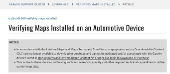

P.s your in second picture it shows the map size to be 4,139,008 which is too large.
I suspect there lies one of your problems.
,GraciasThe working map is the one that was modified 13/5/2021Mike your top picture file size should be ok bottom pic is to large i cant say why mapinstall has allowed that but it should be under 4gb as Yarkto has said.
is the top pic with the working map.
