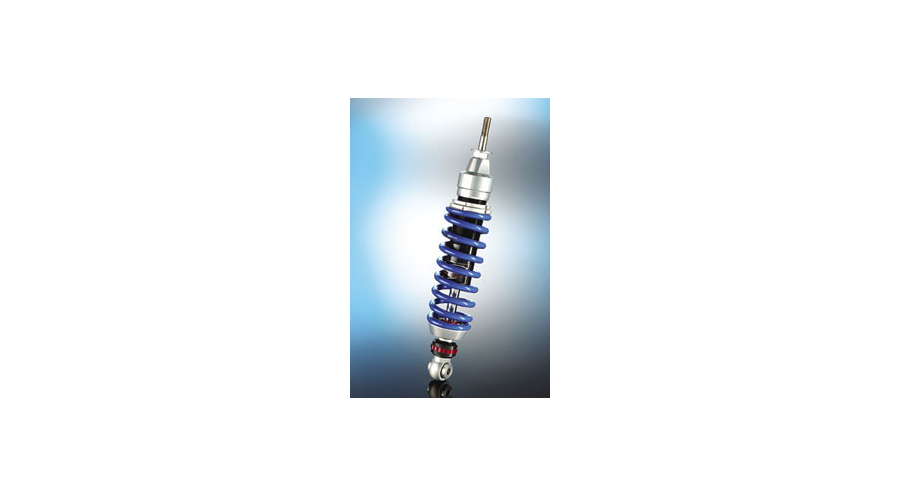

In this pic setting rings are at top..
I`ll ask from the factory. If theyre at top I`ll get HPA at front too or think something else.

No need
They are, just checked mine fitted
Preload Rings definitely at the top...............................kinda stooopid:blast
On my other bike, with Ohlins they're at the bottom
Much more sensible
No need
Much more sensible
