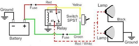

Is it possible to take a Feed direct from the Side Lights without affecting CanBus?
Something like this...............
(Completely independant circuit of other lights and switches on the bike)

Thanks Philbuck.
Only Issue I can see there is that he can leave them on by mistake?
Or, someone else could switch them on whilst the Bike is Unattended.
Thanks Philbuck.
So he (you ;) ) want them wired in with the bike electrics
Eliminate the switch & wiring - Yellow & green in the diagram
you need to wire one side of the relay to the battery, and the other side to the bikes light circuit
I need to find a diagram without a bloody switch lol
if ive got it right, run a wire from pin 86, and tap this into The +12v feed on the low beam bulb holder
If ive got it right, the 12v on pin 86 pulls the relay closed allowing the power to run from pin 30 to 87
you van use a swith if you want, but mine were wired without
If it's wrong someone will shout out ;)
Yes, that makes sense to me.
It'll be me doing the Wiring anyway, so that's all that matters! :D

That said though, will taking a Power Source to the Relay from the Dip Supply create CanBus Issues?
We stuck some LED Bulbs in for him and the Warning Light came on :blast
If you mean, taking the power source for the lights themselves, from the dipped beam circuit, then I'm sure the CanBus will complain. But if you're only taking the "relay" feed (pin 86), from the dipped circuit, you'd probably get away with it, as it'll be minimal current.
Any ignition fed circuit would drive the relay part of things, and you run the main circuit via a fuse from a large current source such as the battery.
No canbus will not complain,
your drawing low current across that side of the relay.
The big load is going across the other non canbus aide of the relay ( if that makes sense)
The leds (spotlights ) shouldn't draw that much power to upset the canbus

i dumped the switch with warning lamp on my install,
Only because everything else was waterproof connectors and lamps but the switch looked like a xmas cracker job;)

the relay is a bit longer and fatter but not by much.
the main dip thing is easy. If you have a light switch like mine then you have off, on side, on headlights then a seperate switch for main or dip beam. But the side light is on as soon as lights go on and stays on regardless of which headlight beam you use.
So I took a feed from the sidelight power supply wire, that way as soon as I switch the side light on I have power going to the switch for the spots, as soon as the lights switch of then power to the spot lights is also off easy.
I use the on off switch for the spots to actually just switch the relay, and the lights then take power directly from the battery. Not much current running through the switch wiring all the current going direct from battery to lights along suitable gauge wire
