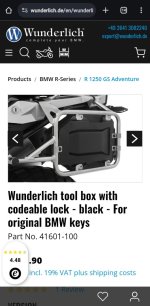

Hello, has anyone ever fitted the Wunderlich pannier mounted toolbox on a 1250 GSA? The reason I ask is that the NN and Wunderlich websites say that it's not compatible with the genuine BMW slash guard. What splash guard does it mean? The Nick Hodge video shows a different version, and it shows the rear wheel fender in place. I can't imagine what else it could mean.
Any help would be appreciated before I order.

I have the Touratech one fitted to mine, and the instructions say the same. The splash guard in question, is the standard one, which is bolted to the final drive and sticks out behind the wheel.
Mine still has the splash guard fitted, and I’ve not experienced any issues in thousands of miles. However, I think the two could come into contact under full rear shock compression (landing from a jump).
