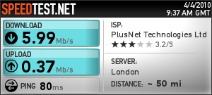

Can anyone tell me how bad this is, it has to be bad because it is always v-slow at everything. :thumb2
As you might guess, that is terrible especially the ping speed of 83ms
What speed are you paying for?

BT's advertising says I can get up to 20mb, which is the package I'm paying for
I'm 1.48km from Exchange,
Speedtest.net says I'm getting 5.84Mb (sunday lunchtime)
BT performance tester at speedtester.bt.com says my D/L speed is approx 6Mb (with max achievable of 7mb)
so speedtest.net & speedtester.bt.com are giving consistent results
