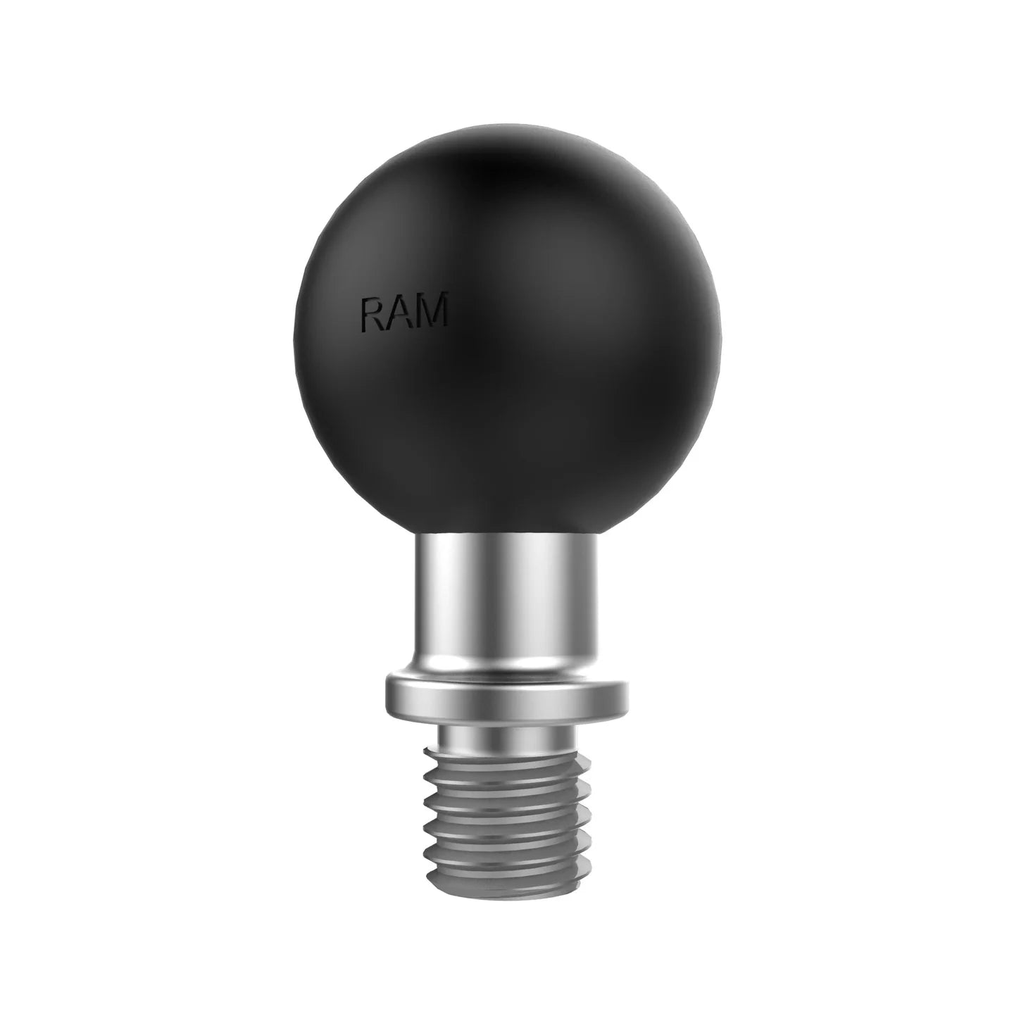

One other question:
Do you or anyone know if the ram mount that can be screwed into a handlebar mirror thread is a standard thread/diameter?
That's great, thank you so much. I'll get on the case.
One other question:
Not sure as bikes use a mixture of M8 and M10 in different thread sizes and some are reversed thread too.
You can get just about every combination of adapter to make it work though.

Thanks for that. Yeah, I was having second thoughts about the suction mount. I've cut out the audio leads etc. I'll connect the nav to the optimate lead and put it in a tank bag with a window or there's a ram mount that connects to the tank fixing and fit the original nav bracket to it. Or maybe fit one in the mirror screw thread as above.
