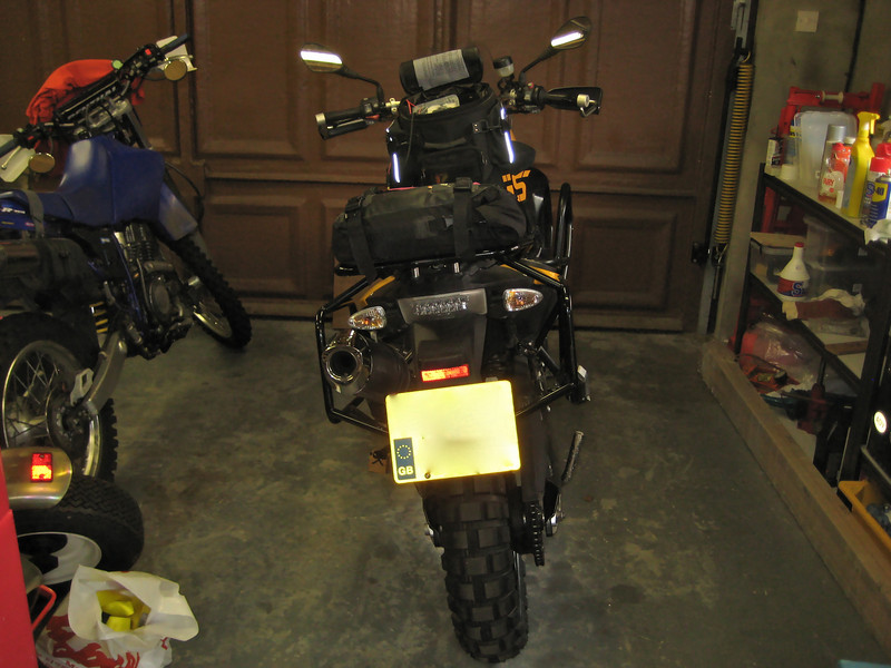

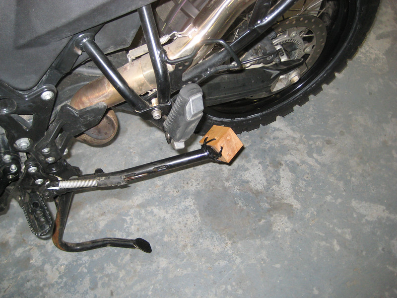

I'm preparing for longish european jaunt, sorting out tools, loading the panniers etc. and I was very concerned about the lean angle and I found my side stand had developed a lot of play but I also found the torx bolt was rather loose. :1/10
However, even after tightening the bike was still leaning over too far so I developed the hi-tech solution shown below. The cable ties are used so I can remove the wooden block easily before going off-road.
Now the bike has an acceptable lean angle.
That block is 5cm thick!
