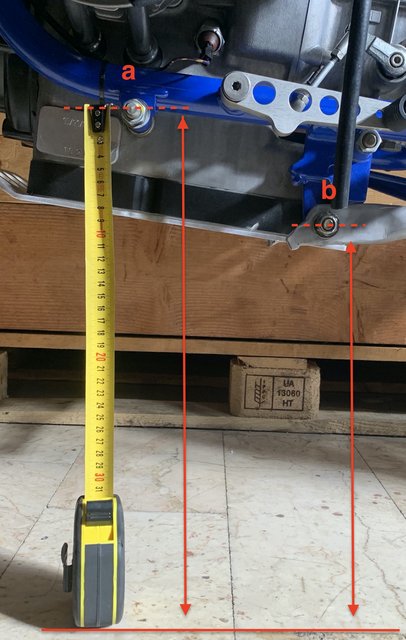

I'm also looking for information on the length of the side and center stand....Because I will have to buy both but first I know which size to buy. I'll try to explain better.
I have a R100GS which should be higher than a standard one. At least that's what I've been told. I have to know
I need to know if it is actually taller or if it is like a standard bike.
Looking at the photo,
Can any of you tell me on a standard R100GS what is the distance of point A and point B from the ground with the bike resting on the ground without side and / or central stand?
thank U

hello, thanks for the answer. I know Motorworks as well as others (motobins, swt, boxersupplies, bmwbayer etc etc). There are standard and extended side and central stands ... and the size is not always indicated. anyway, I need to know if my bike is taller than a standard GS. Not having the possibility to measure a standard GS I wrote here ..

Right, got that. However, the distances you've indicated will surely vary according to how the suspension is set up? Would you not be better giving us the dimensions of your current stands and asking whether that conforms to ours?
Hi Pete, I have no side and central stand.
You can see a central stand in the photo but it is not the right model.
Anyway on my bike the distances are these.
<a href='https://postimages.org/' target='_blank'><img src='https://i.postimg.cc/BQrWdxdL/IMG-5032.jpg' border='0' alt='IMG-5032'/></a><br /><a href='https://postimages.org/it/'>images share</a><br />
I seem to remember that BoxerSupplies sold a 345mm center stand for the taller GS - with elongated forks (modified to rally style). Maybe it could be okay.
On the other hand, I have no idea-reference for the side stand.
However, I would like to know the measurements of a standard R100GS.
