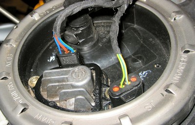

The 12/2010 float

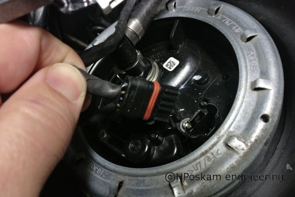

The 01/2011 float
looking at real oem, 01/10 onwards was float for the GS, but the risk is early ones may be cross over level parts
late 2010 on all appear to be float

Is the level sensor not just two wires for the float type and four wires for the film type?

My 2010 twin cam has a float..if you/the seller can open the fuel cap and unscrew the red plastic fitting (easy job!) inside you can see the float attached.
