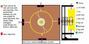

Mr No6, You seem to know what your doing when it comes to wheelbuilding.
As I mentioned a post or two ago, Ive toyed with the idea of doing bmw wheels because very few people do them.
I know its tricky, and potentially dangerous, but so are a lot of things. and I'm not bad at most things.
I designed a jig for initial assembly years ago, but Ive lost my doodles it so ive done it again.
If you can decipher it, do you think it would work efficiently for initial (fairly accurate) assembly.

Hi Den, I'm no expert wheelbuilder, I've done about a dozen so far but only one cross spoke! The only danger is to your sanity, these are weird things to work with.
Your set-up looks a little complex to me. If I was building a jig I'd just have a flat plate to give the correct offset and with the hub and rim positively located to ensure concentricity. The spokes should then be able to be tensioned without any movement between the rim and hub. (in theory!) Runout and concentricity can then be checked with a front wheel mounted on it's own bearings and spindle. Rear wheels don't have bearings so obviously some form of bearing support is required.
The wheel can be laced up very easily without any form of jig, it's the initial tensioning of the spokes that causes problems.
