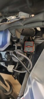

I did this.
Dual USB to replace the original single, plus the Chigee TR100 giving me 4 USB sockets :)
